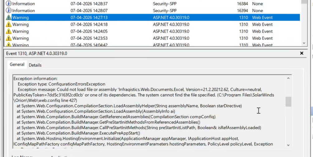

- Checking the server's Event Viewer > Application Logs will show a warning level ASP.NET exception, Event 1310. Could not load file or assembly 'Infragistics.Web.Documents.Excel.
- Additionally, checking OrionWeb logs will show only the following warnings:
2026-04-15 02:15:45,038 [1] (1) WARN SolarWinds.Orion.Web.NetObjectFactory - (null) Net object type "DatabaseFile" with prefix "ABXF" defined in module "APM" does not have a static method called 'GetAllObjects'.2026-04-15 02:15:45,054 [1] (1) WARN SolarWinds.Orion.Web.NetObjectFactory - (null) Net object type "UDTWatchListNetObject" with prefix "UW" defined in module "UDT" does not have a constructor that takes a single string.2026-04-15 02:15:45,069 [1] (1) WARN SolarWinds.Orion.Web.NetObjectFactory - (null) Net object type "PolicyNetObject" with prefix "PEP" defined in module "PolicyEngine" does not have a static method called 'GetAllObjects'.
This indicates the required Infragistics Excel/UI libraries used for export and some UI components are missing from the SolarWinds Platform Web folder, but the assemblies are still referenced in web.config file. This causes ASP.NET to fail during configuration parsing, so the site never starts.

The required Infragistics Excel/UI libraries used for export and some UI components are missing from the SolarWinds Platform Web folder, but the assemblies are still referenced in web.config. This causes ASP.NET to fail during configuration parsing, so the site never starts.
