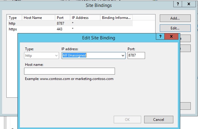

  1. Check IIS and make sure that the IP Address on Binding is All Unassigned.

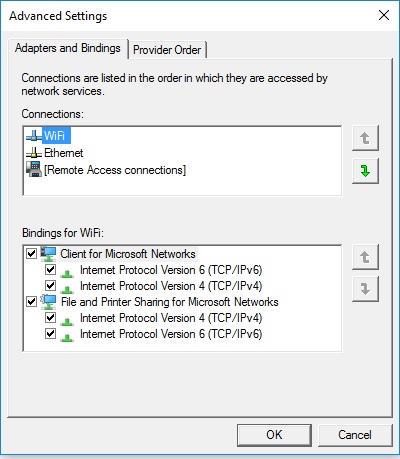

  1. Check the Network Connection if the initial NIC will run first.

  2. Check your Database and look for Website and IP Address should be All Unassigned.
