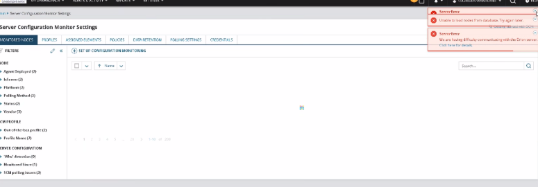

Web Console Displays “Server Error and Unable to Load Nodes from Database” When Accessing the Monitored Tab in SCM
This is to address an issue where you may experience a Server Error or “Unable to load Nodes from Database” message when navigating to the Server Configuration Monitor (SCM) page under the Monitored tab in the SolarWinds Web Console. The error prevents the page from loading Monitored Nodes Page and may also trigger a pop-up stating “We are having difficulty communicating with the Orion Server.”

When opening the SCM Monitored tab, the page fails to load and displays one or more of the following error messages:
  • Unable to load Nodes from Database
  • Server Error – We are having difficulty communicating with the Orion Server.
