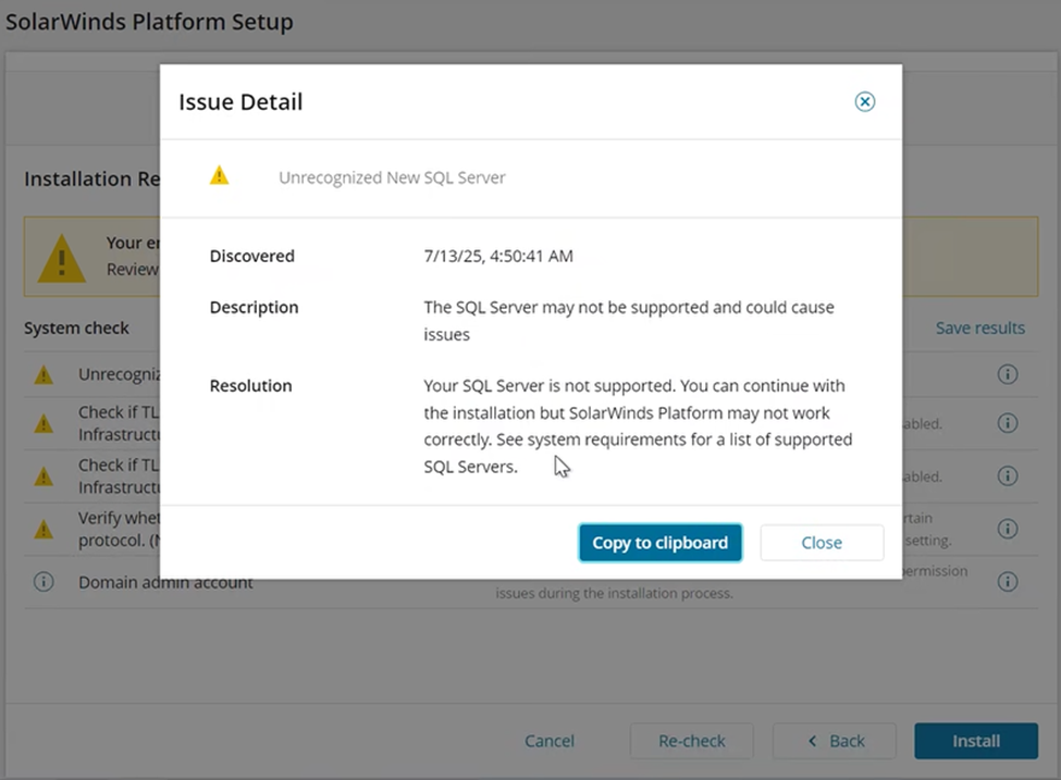

When upgrading to version 2025.1.1, a Warning Message appears stating that "The SQL Server may not be supported and could cause issues. You can continue with the installation, but SolarWinds Platform may not work correctly. See system requirements for a list of supported SQL Servers."
This occurs when running the offline installer.

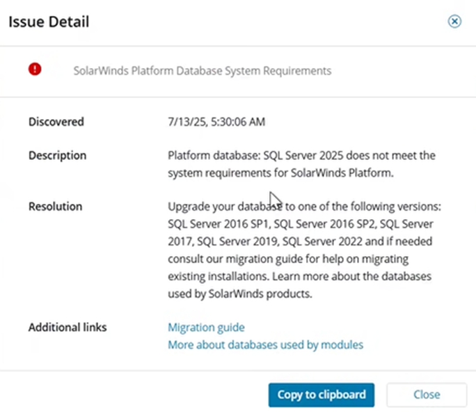

The My Deployment Page shows a warning for the MainPoller --> Platform database SQL Server 2025 does not meet the system requirements for SolarWinds Platform.

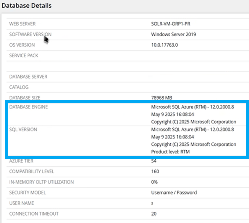

If you go the Web Console and check the Database Details, you will see that the SQL Server version is 2025.
