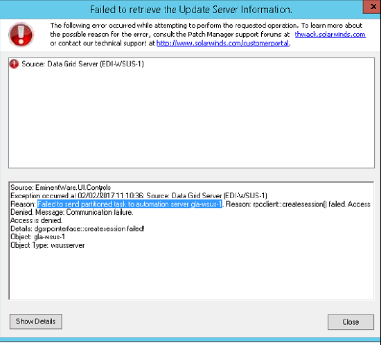

This article provides information and workaround about the below error, that you will get when you tried to access any of the update views of the WSUS server having patch manager AS role as well.
The error also shows up when you tried to access the WSUS(with SAS role) from the drop-down in Server publishing wizard.
Source: EminentWare.UI.Controls
Exception occurred at date_time
Source: Data Grid Server( Server name)
Reason: Failed to send partitioned task to automation server <Server Name>. Reason: rpcclient::createsession() failed. Access Denied. Message: Communication Failure.
Details: dgsrpcinterface::createsession failed
Object: <Server name>
Object Type: WSUS server.
