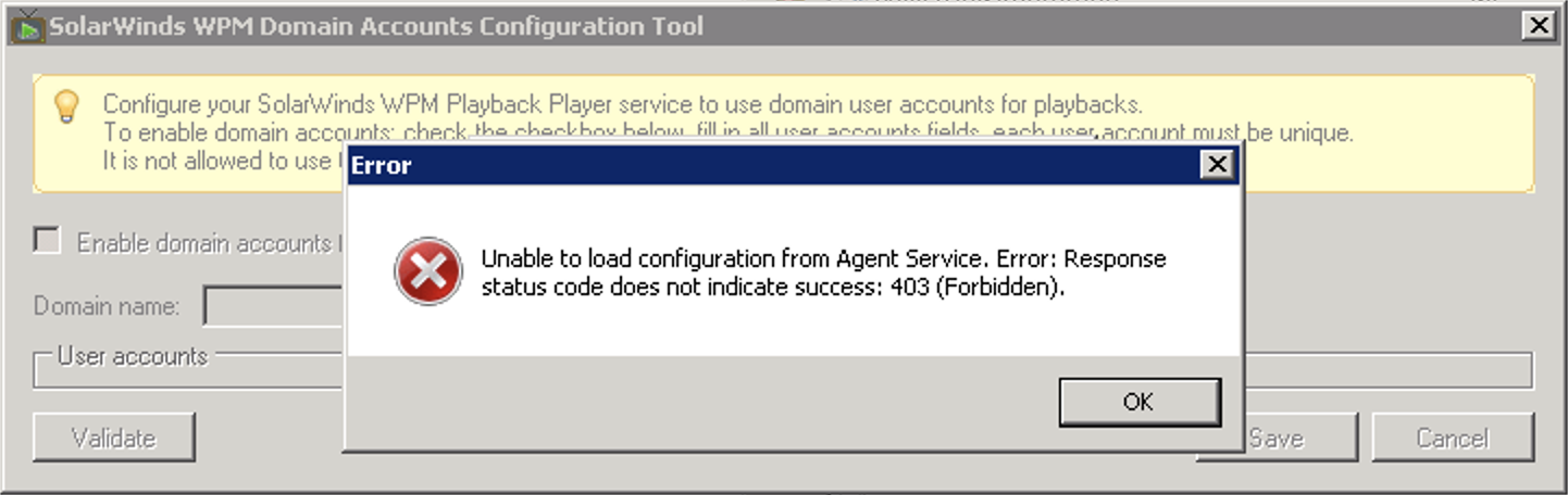

For the Agent Domain Configuration tool
Error: Unable to load configuration from Agent Service. Error: Response status code does not indicate success: 403 (Forbidden).
In logs C:\ProgramData\SolarWinds\Logs\SEUM\AgentSettings.log you will find:
12022-06-03 00:47:36,805 [SolarWinds.SEUM.AgentDomainConfigurationTool.exe][1] ERROR SolarWinds.SEUM.AgentDomainConfigurationTool.MainForm - Unable to load configuration. 2System.Net.Http.HttpRequestException: Response status code does not indicate success: 403 (Forbidden). 3 at System.Runtime.CompilerServices.TaskAwaiter.ThrowForNonSuccess(Task task) 4 at System.Runtime.CompilerServices.TaskAwaiter.HandleNonSuccessAndDebuggerNotification(Task task) 5 at SolarWinds.SEUM.AgentDomainConfigurationTool.AccountsConfigurationClient.<GetAccountsType>d__6.MoveNext() 6--- End of stack trace from previous location where exception was thrown --- 7 at System.Runtime.CompilerServices.TaskAwaiter.ThrowForNonSuccess(Task task) 8 at System.Runtime.CompilerServices.TaskAwaiter.HandleNonSuccessAndDebuggerNotification(Task task) 9 at SolarWinds.SEUM.AgentDomainConfigurationTool.MainForm.<<MainForm_Load>b__6_0>d.MoveNext() 10--- End of stack trace from previous location where exception was thrown --- 11 at System.Runtime.CompilerServices.TaskAwaiter.ThrowForNonSuccess(Task task) 12 at System.Runtime.CompilerServices.TaskAwaiter.HandleNonSuccessAndDebuggerNotification(Task task) 13 at SolarWinds.SEUM.AgentDomainConfigurationTool.MainForm.<SafelyCommunicateAccountsConfigurationService>d__7.MoveNext()

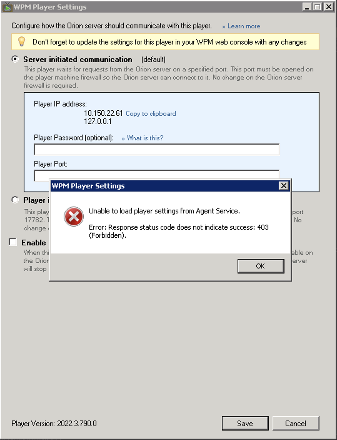

For the Player Settings tool
Unable to load player settings from Agent Service.
12022-06-03 00:49:21,024 [SolarWinds.SEUM.AgentSettings.exe][1] ERROR SolarWinds.SEUM.AgentSettings.MainForm - Unable to load player settings from Agent Service. 2System.Net.Http.HttpRequestException: Response status code does not indicate success: 403 (Forbidden). 3 at System.Runtime.CompilerServices.TaskAwaiter.ThrowForNonSuccess(Task task) 4 at System.Runtime.CompilerServices.TaskAwaiter.HandleNonSuccessAndDebuggerNotification(Task task) 5 at SolarWinds.SEUM.AgentSettings.UserSettingsClient.<Get>d__2.MoveNext() 6--- End of stack trace from previous location where exception was thrown --- 7 at System.Runtime.CompilerServices.TaskAwaiter.ThrowForNonSuccess(Task task) 8 at System.Runtime.CompilerServices.TaskAwaiter.HandleNonSuccessAndDebuggerNotification(Task task) 9 at SolarWinds.SEUM.AgentSettings.MainForm.<MainForm_Load>d__11.MoveNext()Product section

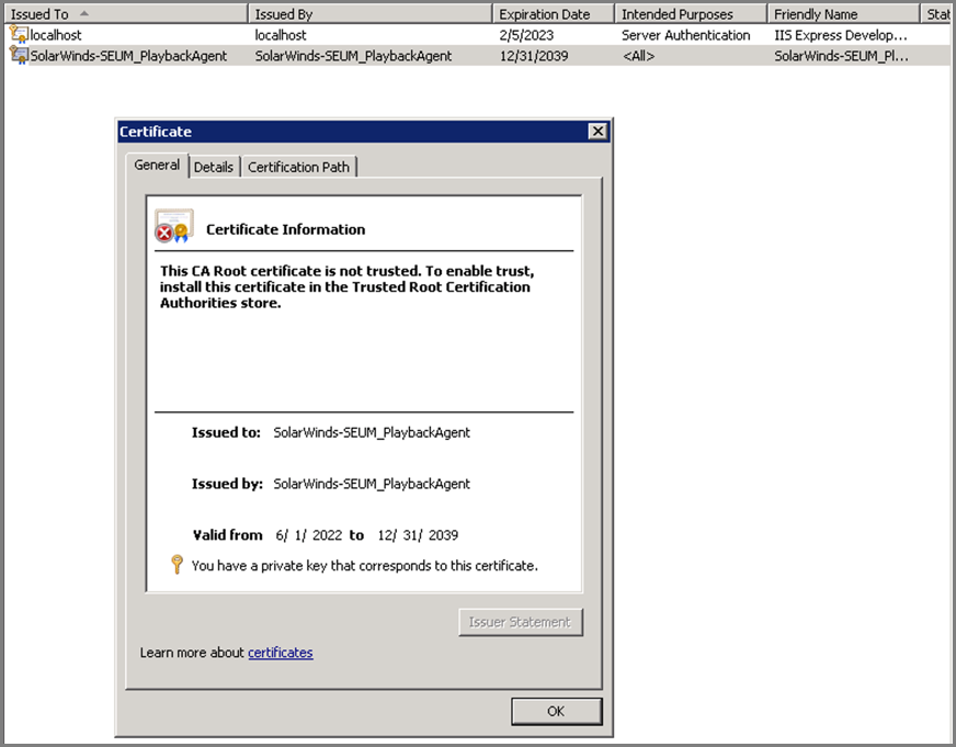

The SolarWinds-SEUM_PlaybackAgent certificate that WPM Playback Player service creates at first run on remote location, and uses to secure communication between itself and those tool, is self-signed and its CA Root is not trusted. Since it is not valid on those specific operating systems, it can’t be used to authenticate successfully during establishing communication between those tools and the WPM Playback Player service.
Copy the SolarWinds-SEUM_PlaybackAgent certificate to the Trusted Root Certificate Authorities store:

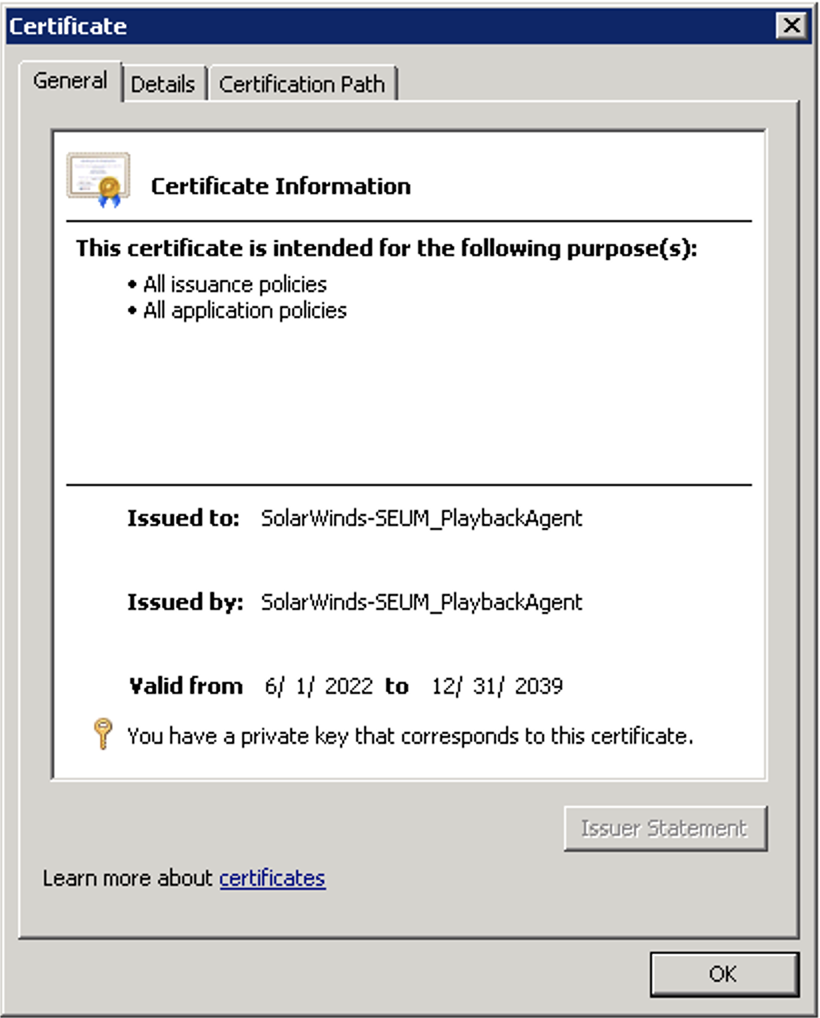

Go back to Personal > Certificates node and open SolarWinds-SEUM_PlaybackAgent certificate. There should be no issue reported with it.
