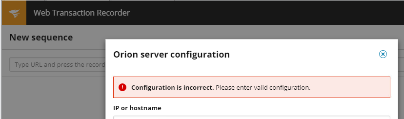

WPM Recorder is not connecting back to the SolarWinds Platform server when using an Active Directory SolarWinds account.
Error: Configuration is incorrect. Please enter valid configuration
The error will look like so:
Web Performance Monitor
The cause of this issue is most likely due to an internal Active Directory navigation issue where SolarWinds cannot see your Active Directory from the remote WPM Recorder location server that we are trying to connect to the SolarWinds Platform server from.
This issue can also be caused by:
  • Trying to connect with a non-WPM admin account
  • Incorrect main SolarWinds poller IP
  • The resolution for this issue is to connect the WPM Recorder to the main SolarWinds Platform server using a SolarWinds Individual Account that is also a WPM Administrator in your SolarWinds Platform Web Console.
  • This Individual Account can be an AD account as long as it's an account on the Individual Account tab.
  • If you continue to see issues with this however then try a non-AD individual account.
