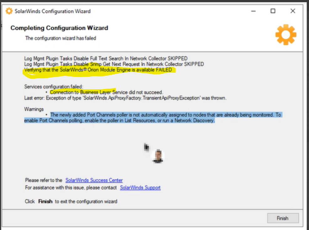

"Verifying that the SolarWinds Orion Module Engine is available FAILED" error in the Configuration Wizard
The SolarWinds Configuration Wizard (CW) fails at “Verifying that the Orion Module Engine is available” (stuck at 0.0% and then fails) in version 2026.1.0 due to a backend service initialization issue.
2/19/2026 5:35 PM
2/19/2026 5:35 PM
In SolarWinds Platform 2026.1.0, the Configuration Wizard may fail during the step “Verifying that the Orion Module Engine is available”, typically stopping at 0.0% and then failing.
This issue occurs when the Business Layer cannot initialize due to a failure in retrieving licensed features from the Feature Service. The root cause is an unsupported SQL connection string parameter (Authentication) introduced when using Azure AD (UPN) authentication with an Azure SQL database.
Because the Feature Service cannot establish a valid database connection, the Business Layer fails to start, which prevents the Orion Module Engine from being verified—causing the Configuration Wizard to fail.
SolarWinds Observability
The issue is caused by using Azure AD (UPN) authentication for the Azure SQL database during Configuration Wizard setup.
When this authentication method is selected, the SQL connection string includes the parameter:
Authentication=...
However, the SQL client used by the SolarWinds Feature Service does not support the Authentication keyword. This results in the following error:
System.ArgumentException: Keyword not supported: 'authentication'
Due to this:
  • Feature Service fails to retrieve licensed features
  • Business Layer cannot initialize
  • Orion Module Engine remains unavailable
  • Configuration Wizard verification step fails
