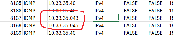

Another cause are the IP addresses with leading zeroes in NodesData table:

Resolution 2:
1) Correct the IP addresses in NodesData table by running SQL query below:
UPDATE NodesData
SET IP_Address = '10.33.35.43'
WHERE IP_Address = '10.33.35.043';
UPDATE NodesData
SET IP_Address = '10.33.35.45'
WHERE IP_Address = '10.33.35.045';
*NOTE: Replace the IP addresses based on what is found in NodesData table
2) And also, run the query below:
UPDATE NodesData
SET IP_Address = LTRIM(RTRIM(IP_Address))
