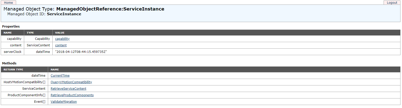

  • You must able to access the vCenter MOB from the affected poller or main poller.
https://Your_vCenter_IP_Address/mob
The Managed Object Browser page displays.
