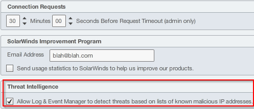

Verify your Threat Intelligence feed is enabled and updating (OLD Flash Console)
  1. Go to Manage > Appliance > Settings.
  2. Verify the feed is enabled as shown below.
    Note: Every morning at 3:14 AM, your SEM updates its Threat Intelligence Feed list. You will find a daily event under Monitor > SEM Internal Events confirming if the update is successful or failed.

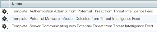

The Threat Intelligence feed has a specific field: isThreat. This field is only displayed on network-related events or event groups, such as events with Traffic in its name. If this field is marked as True, one of the source or destination fields hit an IP address or domain that is blacklisted.

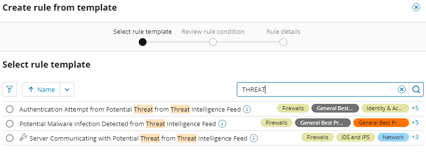

There are three built-in rule templates you can clone and use to be alerted for any suspicious activity. Enable any of these as appropriate for your environment. They should need no customization besides specifying a user to receive the email alert.
With versions 6.7 and later, you can access the rule templates in the SEM Events Console Rules tab.
