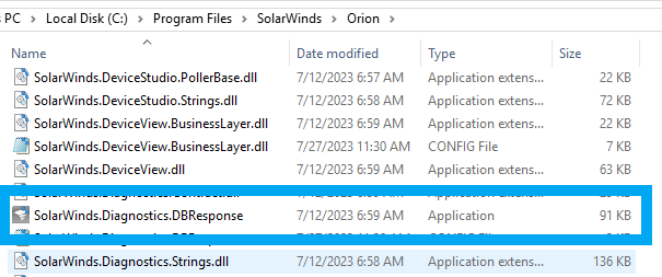

  • The Database Response Tool is located here:
    C:\Program Files (x86)\SolarWinds\Orion\SolarWinds.Diagnostics.DBResponse.exe
  • This tool will be present on all Orion Servers.
  • This tool uses the SQL Connection String set by Configuration Wizard.
Detail
  • Launch SolarWinds.Diagnostics.DBResponse.exe from the Orion Installation directory. The default location is as follows:
     C:\Program Files(x86)\SolarWinds\Orion
NOTE: In version 2023.3.0.Default Path: C:\Program Files\SolarWinds\Orion. The name of the application was changed to SolarWinds.Diagnostics.DBResponse.

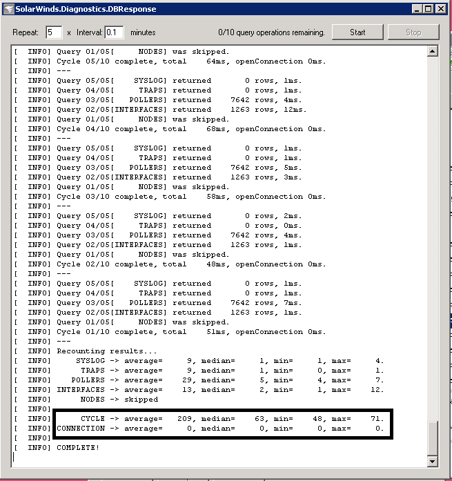

There are 2 settings here: Repeat and Interval (minutes). Repeat sets the number of times you will test and Interval sets how long you will wait between tests.
A Repeat value of 0 will execute once. In the following example results, five tests were used, occurring every six seconds.
  • The statistics displayed are the cumulative results of all tests.
  • The connection results are probably the most important.
    • Results over 300 ms will cause performance issues, and results over 1000 ms will cause crashes.
    • The cycle statistics (cycle meaning, the time it took to connect to the database, query data and return the results) will show you how long each cycle took.
      • 1000 ms is a good benchmark for this, and, 10,000 ms is where you will begin to see issues.
  • If you see one query taking an unusual amount of time, you may want to check that table for index fragmentation or to see if it contains a lot of data.
