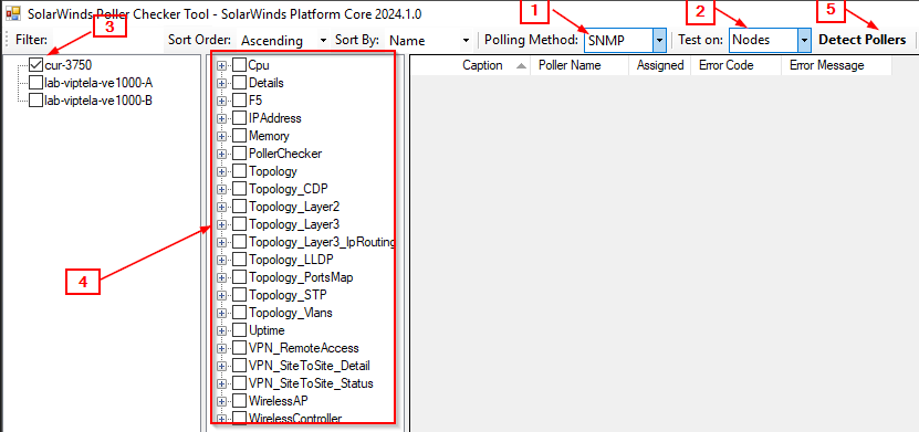

- Select Polling Method = SNMP (1)
- Verify that Test on = Nodes (2) is set
- From the leftmost column, Tick the node (3) you are troubleshooting the issue for. You can search for name/IP in the filter box.
- On the second column, (red box below 4) select an OID-related sub-component that is reporting the wrong value, and you wish to check the assigned/supported Pollers.
You can select all related Pollers or expand the components and select single Pollers. - Click Detect Pollers (5). The pane on the right lists Pollers for the selected components (middle pane) for the entities selected in the leftmost pane. Supported Pollers are green.

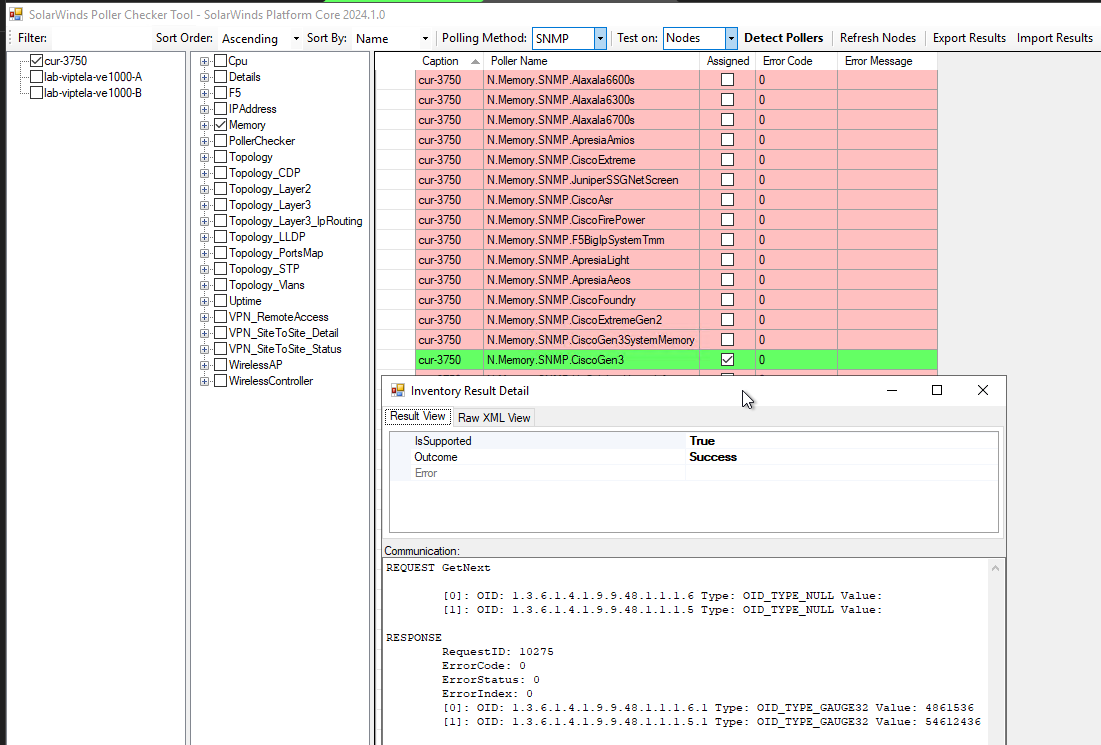

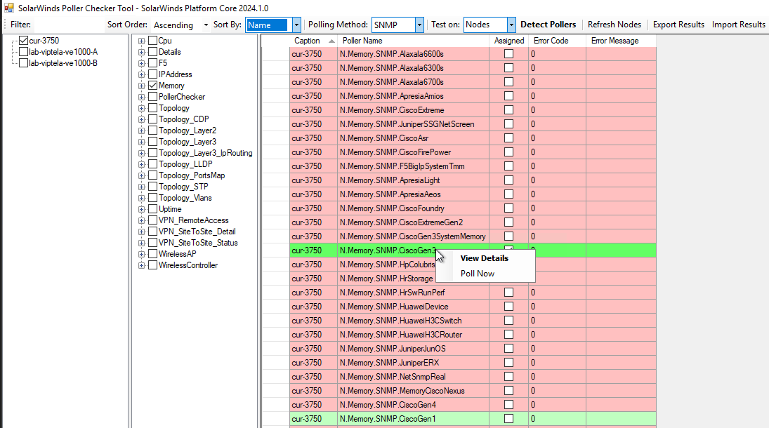

- To verify what a Poller returns, right-click it and select Poll Now.
- Review the results in the popup window to verify the values, you can repeat the steps with different Pollers till you find the one that gives most accurate values.
Here is the code for the colors displayed in the Results pane:
- Light red - Poller is Not Supported on this device, No error Returned
- Dark red - Poller is Not Supported on this device, Error returned See Error message
- Dark green - Poller is Supported on this device, Already assigned to this Device
- Light green - Poller is Supported on this device, But is not Assigned to this Device
