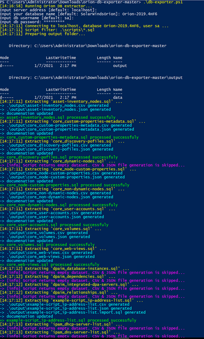

    Script progress appears in the PowerShell Console, as shown in this example:
    If errors occur, review instructions provided. Note that an "empty dataset" message appears for a script if the related module is not detected in your environment. This is normal, expected behavior

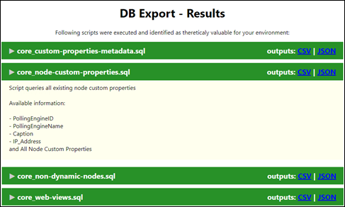

To display script results, click index.html in the output folder. When the DB Export – Results page appears, you can expand individual rows to see a summary of data that was captured. Click CSV and JSON links to open individual output files.
