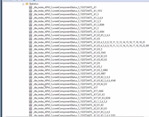

This is being caused by custom indices that were created on these tables by the database tuner tool.
[_dta_index_APM_CurrentComponentStatus_5_1438680223__K1_K5_3_4], [_dta_index_APM_CurrentComponentStatus_5_1438680223__K1_3_4], [_dta_index_APM_CurrentComponentStatus_5_1438680223__K5_K1_3_4_1912], [_dta_index_APM_CurrentComponentStatus_5_1438680223__K1_K5_3_4_4149], [_dta_index_APM_CurrentComponentStatus_5_1438680223__col__], [_dta_index_APM_CurrentComponentStatus_5_1438680223__K5_K1_3_4_2533],

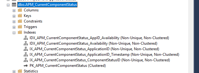

To resolve this, the custom indexes must be removed from the tables that are shown in the ERRORs. The tables are listed in the error as seen below:
Cannot ALTER column: [TimeStamp] on a table: [APM_CurrentComponentStatus]!
Using SQL Management Studio, navigate to this table and remove the indexes. You can right-click ->Delete the unwanted indexes.
They will be listed on the following:
Once all of the custom indexes are removed, the Configuration Wizard will complete as expected.
