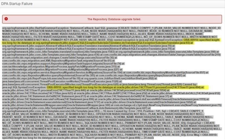

While upgrading DPA to 2024.2 , the repository upgrade is failing at customer’s environment with below error. This issue is seen for ORACLE repository when DOUBLE_BYTE_SYSTEM value is set to TRUE in CONPRM table. This issue is not seen with SQL server, Azure SQL and MySQL repositories. The issue is also not seen when the value of DOUBLE_BYTE_SYSTEM is FALSE (Default).

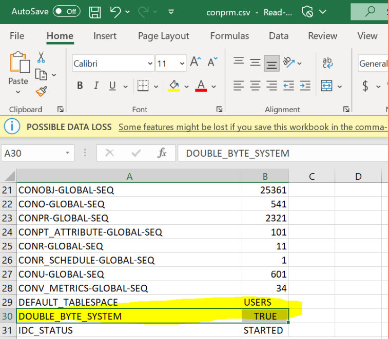

As per analysis Identified that in CONPRM table ,property DOUBLE_BYTE_SYSTEM was TRUE.
If this property is true , DPA’s DDLTranslator let the NVARCHAR datatype used as is during script execution.
As NVARCHAR(4000) is not be a suitable length in the standard Oracle server setups, therefore script error out : “specified length too long for its datatype”
Whereas,if the property is false translator will process NVARCHAR to VARCHAR and executes the script.
VARCHAR(4000) is under valid range and therefore DPA installer runs smoothly.

  1. Check DOUBLE_BYTE_SYSTEM in Advance options → System Options → Support Options
Default value of this property is FALSE.
OR
run query on DPA repo : select V from CONPRM where P='DOUBLE_BYTE_SYSTEM'
  1. If it is set to true , update it to false from back-end (this Advance option is read only from UI) by running query on DPA repository schema as :
update CONPRM set V = 'false' where P = 'DOUBLE_BYTE_SYSTEM'
