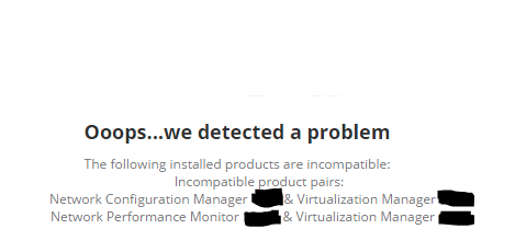

This article explains an issue where the Orion installer detects an incorrect version of Virtualization Manager than what is actually installed on the Virtualization Manager server. Oops...We detected a problem The following installed products are incompatible.

***Make sure customer has upgraded Virtualization Manager and NCM to a compatible version with the version of NPM you are trying to install. The resolution will depend on if the VMAN server is upgraded accordingly. *****
This article explains an issue where the Orion installer detects a incorrect version of Virtualization Manager than what is actually installed on the Virtualization Manager server.
Orion Platform
This issue is caused by a bug in the Orion integration holding on the initial version the integration that it was currently working with.
  1. Navigate to the web console > Settings --> Virtualization Settings.
  2. Click 'DISABLE INTEGRATION.'
  3. Navigate to the Orion server.
  4. Open up Add/Remove Programs from the Control panel.
  5. Uninstall the 'SolarWinds Virtual Infrastructure Monitor' module.
  6. Run the Orion Configuration wizard until finished (Please run if it does not pop up automatically).
  7. This should resolve the install issue. Please re-run the installer and finish accordingly.
