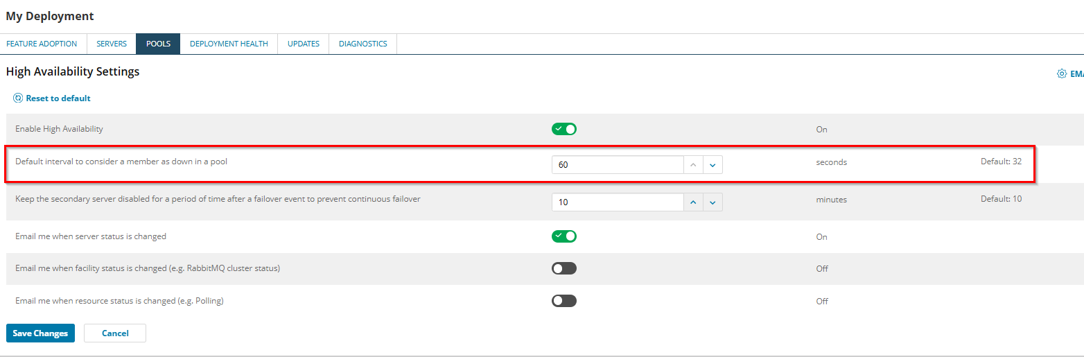

To adjust the rule "default interval to consider a member as down in a pool", head to the HA settings in the web console and adjust the below:
Configure SolarWinds Platform High Availability settings
