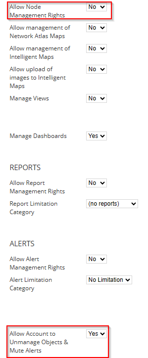

The issue only appears for accounts configured with a specific permission combination:
  • "Allow Node Management Rights" = No
  • "Allow Account to Unmanage Objects & Mute Alerts" = Yes
  • "Allow Real-Time Polling" = No (located under the Performance Analysis Settings section)
When a user with this combination opens a Node Details page and selects Maintenance Mode → Unmanage Now, the web console briefly reports success, but the object's status does not change to Unmanaged. Administrator accounts, and accounts that also have "Allow Real-Time Polling" enabled, are not affected.
The trigger permission configuration is shown in Figure 1.
Figure 1: Account "Define Settings" page showing the permission combination that triggers the issue — node management rights disabled, unmanage/mute rights enabled.
