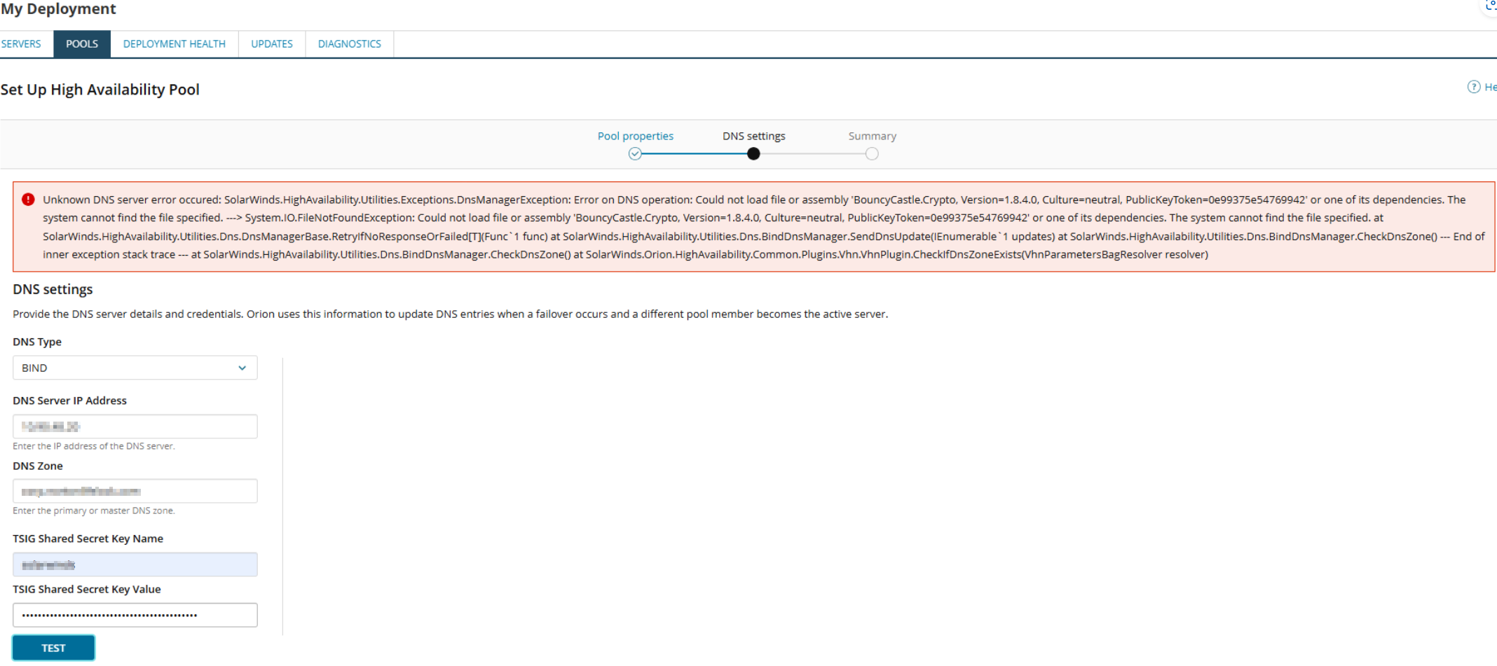

After upgrading to SolarWinds Platform version 2025.2, users attempting to set up or validate TSIG credentials in the HA Pool DNS Settings may encounter the following error:
Unknown DNS server error occurred.
SolarWinds.HighAvailability.Utilities.Exceptions.DnsManagerException: Error on DNS Operations: Could not load file or assembly 'BouncyCastle.Crypto, Version=1.8.4.0, Culture=neutral, PublicKeyToken=0e99375e54769942' or one of its dependencies. The system cannot find the file specified.
---> System.IO.FileNotFoundException: Could not load file or assembly 'BouncyCastle.Crypto, Version=1.8.4.0, Culture=neutral, PublicKeyToken=0e99375e54769942' or one of its dependencies. The system cannot find the file specified.
   at SolarWinds.HighAvailability.Utilities.Dns.DnsManagerBase.RetryWithResponse(...)
   at SolarWinds.HighAvailability.Utilities.Dns.BindDnsManager.SendCheckUpdate(...)
   at SolarWinds.HighAvailability.Utilities.Dns.BindDnsManager.CheckDnsZone()
--- End of inner exception stack trace ---
   at SolarWinds.Orion.HighAvailability.Common.Plugins.HAPlugin.CheckDnsZone(...)
In the HighAvailability.Service.log at C:\ProgramData\SolarWinds\Logs\HighAvailability, you may also see:
INFO  SolarWinds.HighAvailability.Utilities.Dns.DnsManagerBase - DNS query attempt failed: Could not load file or assembly 'BouncyCastle.Crypto, Version=1.8.4.0, Culture=neutral, PublicKeyToken=0e99375e54769942' or one of its dependencies.
This issue prevents completion of HA pool setup and DNS updates from being validated during TSIG credential testing.
