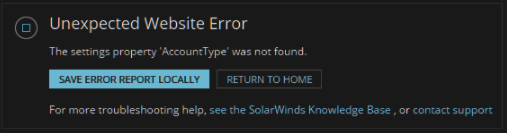

Unexpected Website Error: The settings property 'AccountType' was not found in Orion
This article addresses the issue where the following error occurs while Adding a new AD account or updating an existing AD account in the Orion web console
When adding a new AD account or updating an existing AD account in the Orion web console, you might encounter an error,
Unexpected Website Error The settings property 'AccountType' was not found.
Sample Image:
This article describes and addresses this issue in your Orion Web Console
You added an AD group account and now trying to Add individual AD account of the group in Orion.
