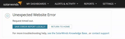

In Network Discovery, after entering the Subnet or IP addresses to discover and selecting next, the following Unexpected Website Error occurs:

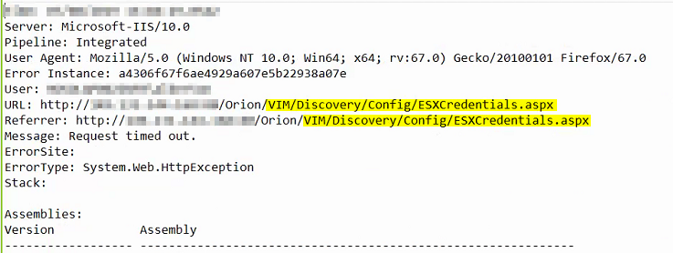

Saving the error report locally and opening it shows something like the below:
… /Orion/VIM/Discovery/Config/ESXCredentials.aspx
Message: Request timed out
