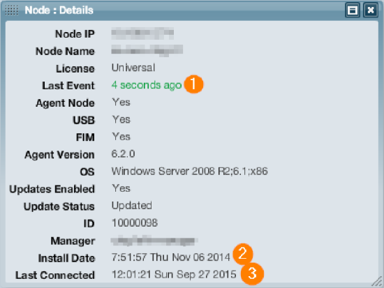

The important thing is that there are a number of “times” that describe the SEM Agent and the last time it functioned. In the SEM Flash console, double-click a node, and you see this information.
  1. Last Event: This is the last time an event came from this node. In this example, that was four seconds ago.
  2. Install Date: This is when the Agent was first installed/came on-line to communicate with the SEM appliance.
  3. Last Connected: This is the last time the SEM Agent went through a complete handshake with the Log and Event Manager appliance. In the example, this is more than 4 seconds ago.
In the SEM HTML5 console, you can find this information on agents in the Nodes tab, or by clicking a node in the Node Health widget in the SEM Dashboard.
