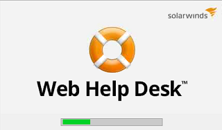

      The installation may require several minutes to complete.

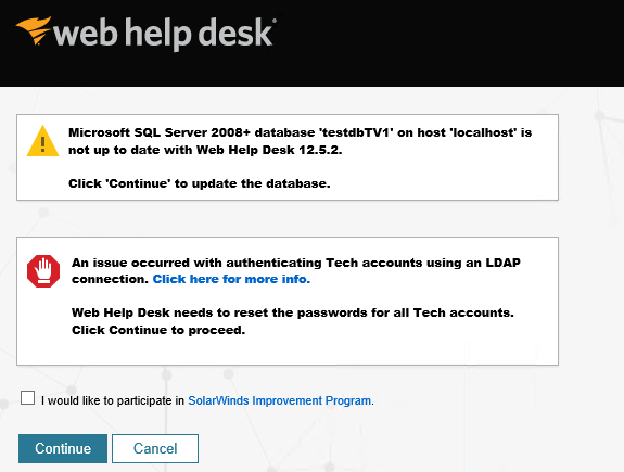

      When the installation is complete, a dialog box displays, stating that the PostgreSQL database is not up to date with Web Help Desk 12.5.2.
  5. Click Continue to complete the database update.
    The update process may require several minutes to complete.
