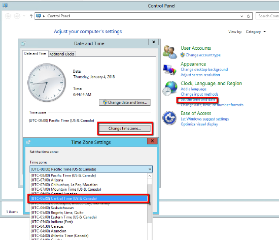

The time zone set on the client is different from the SWIS time zone.
Set the date, time and time zone on your server to correspond with the SWIS time zone.
To find out the time zone to set, contact your database administrator.
  1. From the Start screen of the MultiPoint Server computer, open Control Panel.
  2. Under Clock, Language, and Region, click Set the time and date.
  3. On the Date and Time tab, verify the date and time. If they are not correct, click Change date and time, update the date and time, and then click OK.
  4. Under Time zone, verify the time zone.
  5. If it is not correct, click Change time zone, select the correct time zone, and then click OK.
  6. Click OK again to save your settings and close the dialog box.
  7. Restart all services - Shutdown and restart Orion services
The Node Details page now displays the current time zone without issues.
