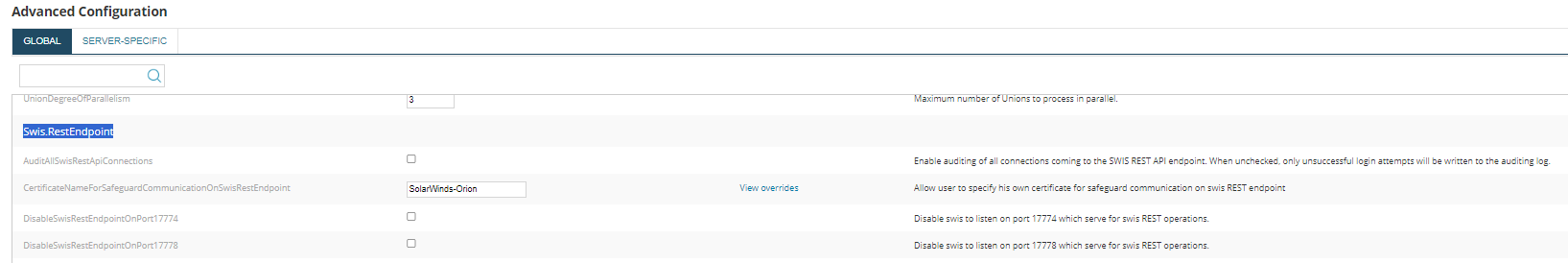

The issue occurs due to the Global settings on the Advanced Configuration page:
Swis.RestEndpoint.CertificateNameForSafeguardCommunicationOnSwisRestEndpointcustomers.certificate.net
Swis.RestEndpoint.DisableSwisRestEndpointOnPort17778TRUE
To workaround this problem, perform the following steps:
  1. In http://OrionHostname/Orion/admin/AdvancedConfiguration/global.aspx, Set the following back to default:
    • CertificateNameForSafeguardCommunicationOnSwisRestEndpoint
    • DisableSwisRestEndpointOnPort17778
  2. The Swis.RestEndpoint should look like this:
  3. Hit SAVE
  4. Restart all Orion services from main and additional polling engine/web servers.
This should stabilize the Recommendations and Orion Module Engine services, and you should be able to upgrade your agents to the latest version moving forward.
