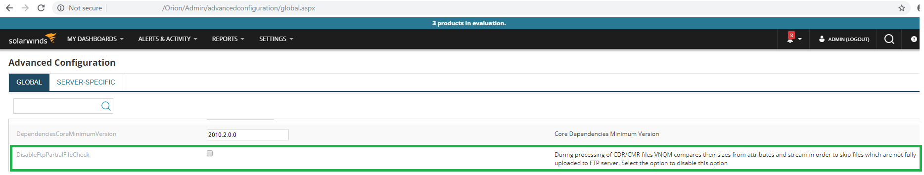

This is due to either an issue with the CUCM or the FTP server.  It may be that the CDR / CMR is still being written or the file is not completely updated by the CUCM.
First, try using a different FTP server. In case that doesn't work, follow the steps below:
  1. In the Orion Web Console, access the Advanced Configuration options. For more information, see Advanced Configuration access in Orion Platform.
  2. Scroll down to the section Ipsla.BusinessLayer.Settings.
  3. Select DisableFtpPartialFileCheck.
  4. Click Save
