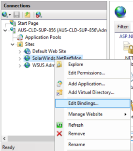

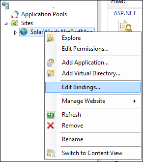

  1. Open IIS Manager.
  2. Right-click the SolarWinds website, and then select Edit Bindings.
    (Screenshot property of © 2019 Microsoft)

  3. Right-click the SolarWinds website, and then select Edit Bindings.

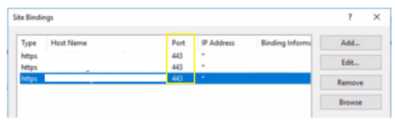

5. Check the site binding ports used

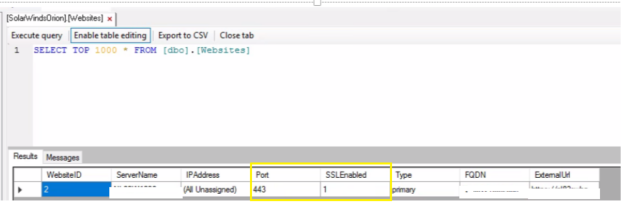

  3. Right-click on SolarWindsOrion database and select New query.
  4. Open the Websites table and execute the query to view.
  5. To update the Port and SSL Enabled press Enable Table Editing
  6. Change the value of Port to 443 and SSL Enabled to 1
         7.  Run the report once again it will work using the HTTPS URL
