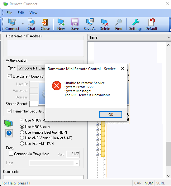

However, on this issue, the administrator is unable to connect to any target computer. When trying to remove/uninstall the agent services, getting an error:
"Unable to remove Service
System Error: 1722
System Message: The RPC server is unavailable."
