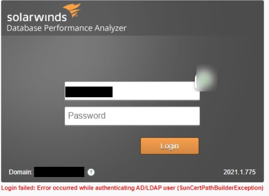

Unable to login to DPA-Login failed: Error occurred while authenticating AD/LDAP user (SunCertPathBuilderExeption)
When a DPA user is trying to sign in to DPA, they are unable to. Below the login prompt, the following error is in red text "Login failed: Error occurred while authenticating AD/LDAP user (SunCertPathBuilderExeption)"

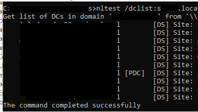

One way to know what servers DPA can connect to from a Windows install is to run the command line command
nltest /dclist: yourDomain
When I run this local, I get a list of DCs that I can connect to for our test lab domain.
