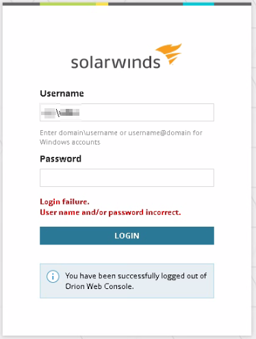

This article explains when a local SolarWinds Platform account can log in successfully while a Windows credential cannot and then throws the error below in the SolarWinds Platform Web Console when attempting to login.
Login Failure.
User name and/or password incorrect.
