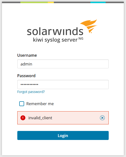

Login to the Kiwi Syslog Server NG administration interface is failing with an "invalid_client" error
Login attempts to the Kiwi Syslog Server NG admin console fail, displaying an “invalid_client” error.

The “invalid_client” error occurs when the Kiwi authentication interface is unable to validate against its internal identity service, typically due to configuration corruption or mismatch. This condition is often observed after installation/repair operations, disk full events, Windows account modifications, or manual file replacements.
This issue is likely caused by corruption of required system files.
Perform a clean reinstallation to eliminate any potentially corrupted files. During the uninstallation process, please select the option to delete all saved settings to ensure a complete clean reinstall.
