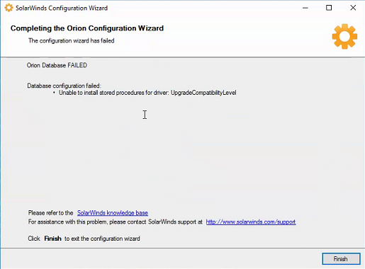

When running the Configuration Wizard, you may receive the error below:
ERROR:
Orion Database FAILED Database configuration failed:
•  Unable to install stored procedures for driver: UpgradeCompatibilityLevel
You will also find a similar error in the ConfigurationWizard.log files that are located in the C:\ProgramData\SolarWinds\Logs\Orion folder.
ERROR TaskAdapter - Error running task Orion.ConfigureDatabase Orion Database
System.InvalidOperationException: Unable to install stored procedures for driver: UpgradeCompatibilityLevel ---> System.Data.SqlClient.SqlException: Cannot drop the procedure 'UpgradeCompatibilityLevel', because it does not exist or you do not have permission.
