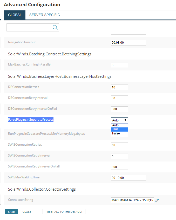

  1. Go to Orion Advanced Configuration (http://xx.xxx.xx.xx:8787/orion/admin...on/Global.aspx).
  2. Locate SolarWinds.BusinessLayerHost.BusinessLayerHostSettings.
  3. Find ForcePluginsInSeparateProcess and change option from Auto to True
  4. Click SAVE
