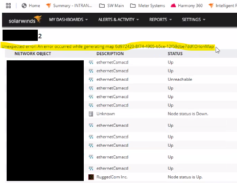

Unable to import Network Atlas Map to SolarWinds Platform Maps - error "Unexpected error: An error occurred while generating map xxx.orionmap"
After importing a Network Atlas map into SolarWinds Platform Maps, users may encounter the error message: "Unexpected error: An error occurred while generating map xxx.orionmap."
12/17/2025 9:51 PM
12/17/2025 9:51 PM
This error appears in the web console when attempting to open or generate a Network Atlas map that was imported into SolarWinds Platform Maps.
