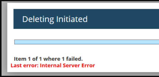

When the interfaces are selected and delete is clicked an internal server error is seen.

The following error is seen on the web console and the selected interfaces are not deleted.
