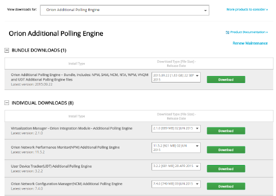

When NCM is using an Orion Core structure where Additional polling engines are part of the environment, it is mandatory to install the Individual polling engine plugin on the Orion Additional Polling engines.  These are included in the Orion Additional Component Download and not the NCM installer download.
  1. Download the Additional Polling Engine Installer from the SolarWinds Customer Portal.
  2. Save it on the Additional Polling Engine server for both the Core and the NCM additional Polling engine.
