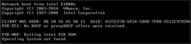

This document provides steps on how to recover an unbootable SEM appliance where-in the user has accidentally deleted SEM's OS Partition (hard disk1) from VMware's V-Center console. At appliance boot up, you get below PXE message: "Operating System not found"

  • In some instances, during the boot process of your SEM or LEM appliance, you may come across a PXE boot error. This occurs when the SEM OS Partition (hard disk1) has been unintentionally deleted from the VMWare V-Center console. Once the VM is powered on, you will encounter the following PXE error message
PXE-M0F: Exiting Intel PXE ROM.

  • While resizing the Log/Data partition, user accidentally deletes the SEM(LEM) OS disk/partition (hard disk1) from VMWare V-Center console. Below message is displayed while booting the SEM appliance.

Message during boot:
-  PXE-M0F: Exiting Intel PXE ROM. - "Operating System not found"
