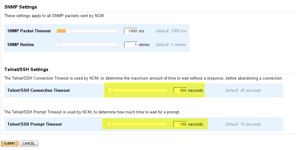

Increase the timeout values in:
  • Telnet/SSH Connection Timeout (default value is 45 seconds and you could increase this to 200 seconds)
  • Telnet/SSH prompt Timeout (default value is 15 seconds and you could increase this to 150 seconds)
Once the values are adjusted and the application is restarted, re-try configuration backup.
To set the Telnet/SSH timeout adjustments in NCM:
1. Log in to the Orion Webconsole and click Settings > NCM Settings.
2. Click Protocol Settings. From Telnet/SSH Settings, set the timeouts and click Submit.
