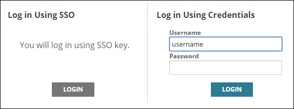

  1. Go to http://<SEMHostName>:8080/mvc/login.

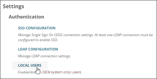

  2. Log in using credentials with an LDAP or SSO user.
  3. In the Settings window, click LOCAL USERS.
  4. Move the slider to enable the admin user.

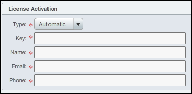

  7. Under the Properties section, select the License tab.
  8. Click Update License if the license activation is expired or if it is already set. Otherwise, you should see the Key, Name, Email, and Phone fields open to be edited.
  9. Add the required information.
  10. Click Activate.
