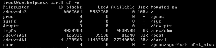

Unable to access to the WHD Web Console. Running the df - a /dev/sda3 shows that the available space is 0 and used space is 100%.

When you access Web Help Desk in a Linux environment, the process fails. If you execute df - a /dev/sda3 in a command line, the results show that the available space is 0 and used space is 100%.
Web Help Desk
Either the catalina.out log is filling up most of the main partition or the PostgreSQL database backup is filling the /data1/backup folder.
1. Log in to the Web Help Desk server using the administrator or root account.

3. Run command df -h to confirm if the webhelpdesk folder or /data1/backup drive is full.
4. Navigate to /usr/local/webhelpdesk/bin/tomcat/log and delete all files inside the folder. Either use the command below or use WinSCP to delete the files.

cd /usr/local/webhelpdesk/bin/tomcat/log

rm -rf catalina.out
5. Navigate to /data1/backup and see how many database backups exist. You can delete old backups with the customer's permission to make more disc space. Either use the command below or use WinSCP to delete the files.

rm -rf whdbackupfilename
