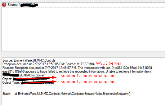

This article describes an issue where you are unable to browse and access the Patch Manager and the 'automation server unable to access dgsrpcinterface createsession failed SmoException' error is found in the EWDGS logs.

This article describes an issue where you are unable to browse and access the Patch Manager Console and the following error is found in the EWDGS logs:
2017/07/06 13:23:29:412 PID: 7104 TID:  6168 [ERROR] SMO InnerException: An exception occurred while executing a Transact-SQL statement or batch.
    at Microsoft.SqlServer.Management.Smo.SqlSmoObject.AlterImpl()
   at EminentWare.DataQueryAdapters.CMDBManager.SetAutoCloseOff()
2017/07/06 13:55:57:567 PID: 7104 TID:  4948 [ERROR] MonitoringAndSychronizationRequest::ExecuteDiagnosticsRequest(auto) to server: V1TSSPM03 failed. Message: Communication failure.
The RPC server is unavailable.
Details: dgsrpcinterface::createsession failed!
Stack Trace:    at EminentWare.Core.Client.RPC.rpcclient.createsession(String operation, String subsystem, String taskid)
   at EminentWare.DataGridServer.Executive.MonitoringAndSychronizationRequest.ExecuteDiagnosticsRequest()
