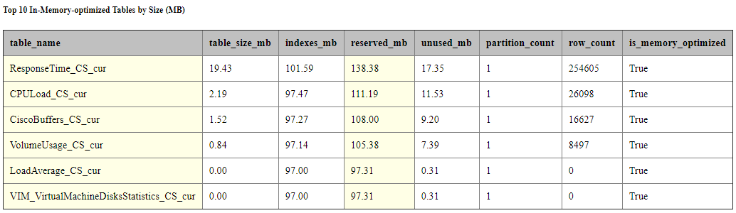

The In-Memory feature disallows the normal shrink.
Network Performance Monitor
  • In-Memory-Optimized Table Found
