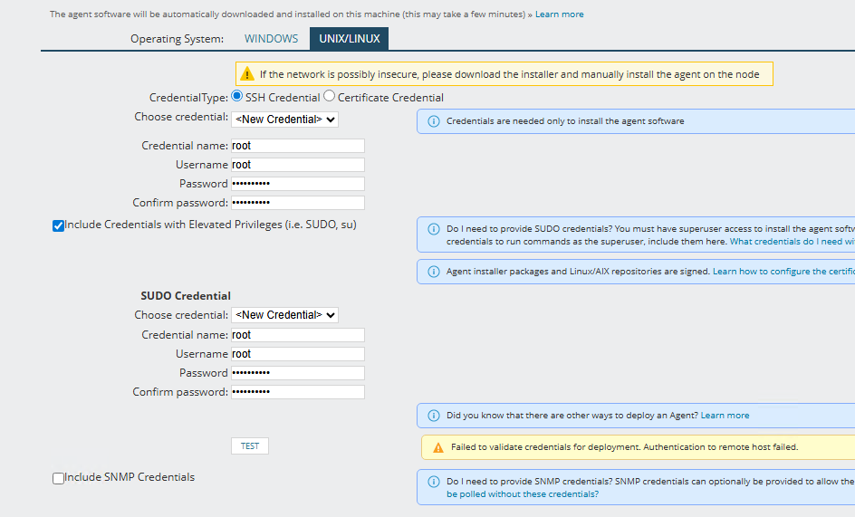

When deploying the SolarWinds Platform Agent to a Linux/Unix host via push deployment, the platform validates the provided SSH credentials before installation begins. This credential test confirms that the SolarWinds Platform server can connect to the target machine, identify the operating system, and transfer files via SFTP/SCP. When this step fails, you'll typically see this error message:
  • "Failed to validate credentials for deployment. Authentication to remote host failed."
Orion Platform
Potential causes:
-port 22 blocked
-Unable to resolve Hostname
-Incorrect credentials
-Inefficient access with provided credentials
-Low Space in the /usr directory
-sftp service not running
-incompatible operating system

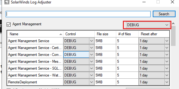

To find out what might be causing issues with the potential connection, you'll need to open up LogAdjuster.exe on the polling engine that the Agent will be assigned to.  At the top of Log Adjuster, there will be a section for Agent Management. Set the whole section to DEBUG and click Apply at the bottom.
After setting the logging to DEBUG, you'll then need to test pushing the Linux Agent and let the failure occur. Next, navigate to C:\ProgramData\SolarWinds\Logs\AgentManagement\ and find the RemoteDeployment.Worker.log. Review the log for any potential failures.
