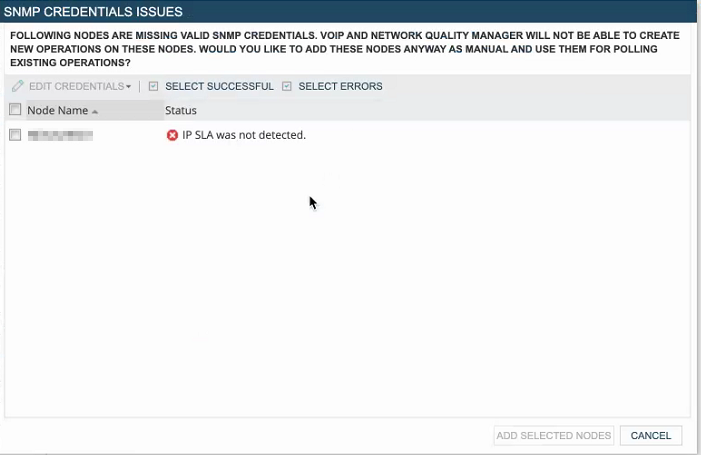

The following error is received when adding a node to VNQM:
ERROR: IP SLA Not Detected
VoIP & Network Quality Manager
This can be caused by the following:
  • Router does not support IP SLA.
  • Router does not support the required OIDs.
  • VNQM polls the following OID to determine if a node is IP SLA-capable:
    1.3.6.1.4.1.9.9.42.1.1.1.0
    If there is no response from this OID, then the node is not IP SLA-capable.
This is a device issue. A possible solution may be a firmware upgrade but this will have to be confirmed by Cisco.
