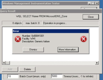

This is an issue on the DNS server.
NOTE: Run the following steps from the IPAM server, and then send the output to our Support team.
  1. Click Start > Run, and enter wbemtest.
  2. Click OK
  3. Click Connect.
  4. In Namespace, enter \\<ipaddress of DNS server>\root\MicrosoftDNS.
  5. Enter the username and password used for IPAM.
  6. Click Connect, and then click Query.
  7. Enter the following query:
SELECT Name FROM MicrosoftDNS_Zone
  1. Click Apply
You should See the DNS Zones, similar to MicrosoftDNS_Zone=<no key> for each zone.
  1. Double-click one of the entries above to see the zone name at the bottom.
  2. Save screen shots of the output, and send them to Support.
Note: The same issue is experienced when running the Wbemtest locally on the DNS server. This confirms that the issue is with the DNS server and not an issue within IPAM.
