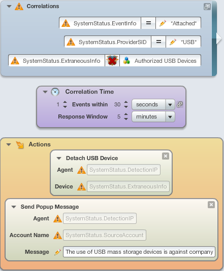

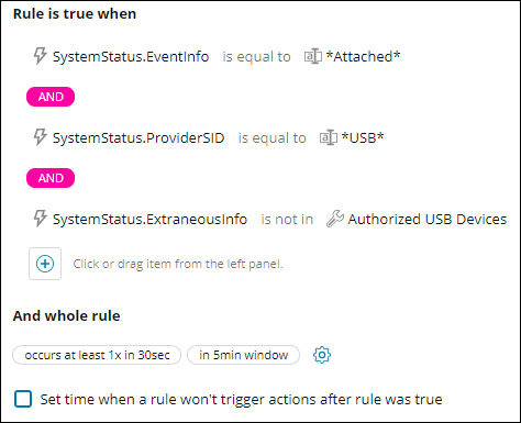

Verify the Detach Unauthorized USB Device rule has the correct settings. It should appear as below:
SEM HTML5 console
SEM Flash console
