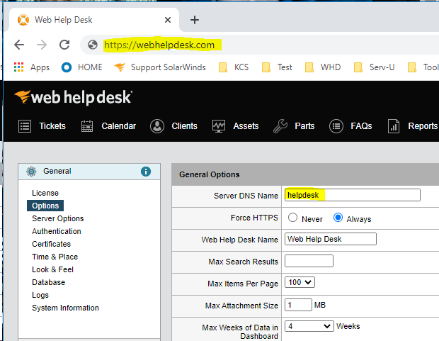

Example 1:
- Current Web Help Desk URL is 'https://webhelpdesk.com'
- The Server DNS Name is 'helpdesk'.
- The URL that will be used in the emails, attachments, FAQs and surveys will be 'https://helpdesk' and not 'https://webhelpdesk.com'

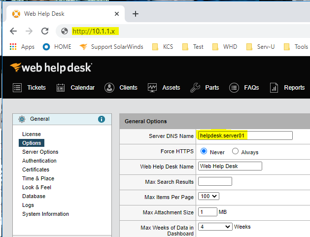

Example 2:
- Current Web Help Desk URL is 'http://10.1.1.x'
- The Server DNS Name is 'helpdesk.server01'.
- The URL that will be used in the emails, attachments, FAQs and surveys will be 'http://helpdesk.server01' and not 'http://10.1.1.x'
Depending on the DNS or firewall settings, the Server DNS Name might be unreachable from external machines.

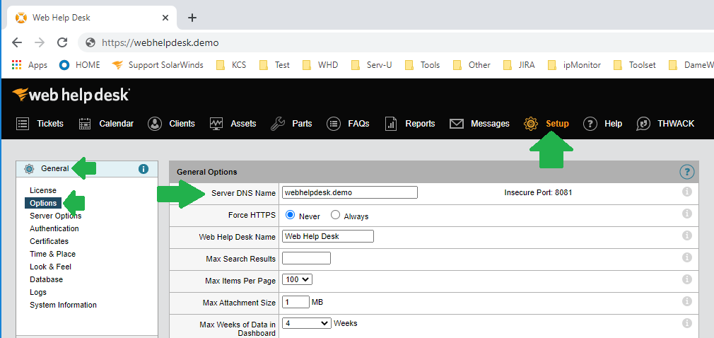

- Log in to Web Help Desk as an administrator
- Go to Setup > General > Options
- Look for the Server DNS Name field
- Change this value to the actual Web Help Desk URL (either IP address, local DNS or public DNS) that is used to access the Web Help Desk portal.
- Set the port to be used, either HTTP or HTTPS in the Force HTTPS field.
