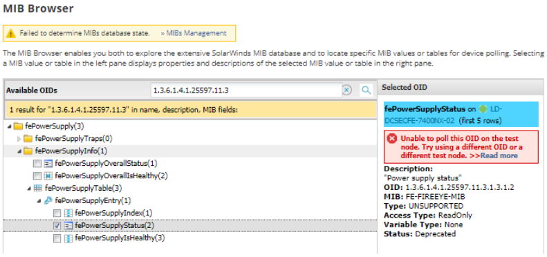

The following errors appears when creating a new universal device poller (UNDP) with an unknown OID:
This OID is not supported
Unable to poll this OID on the test node. Try using a different OID or a different test Node.
