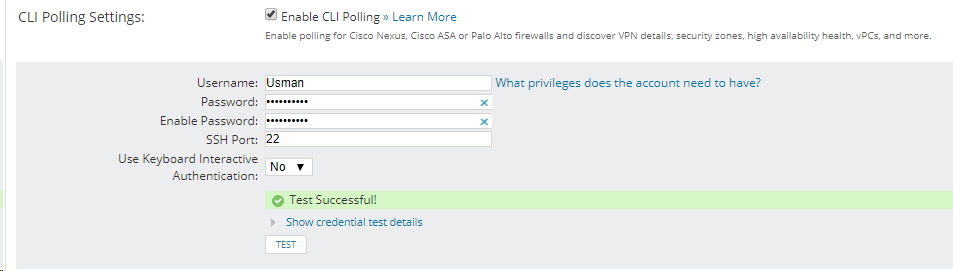

Once this is done let's test our connection
Example Case:  Success connection

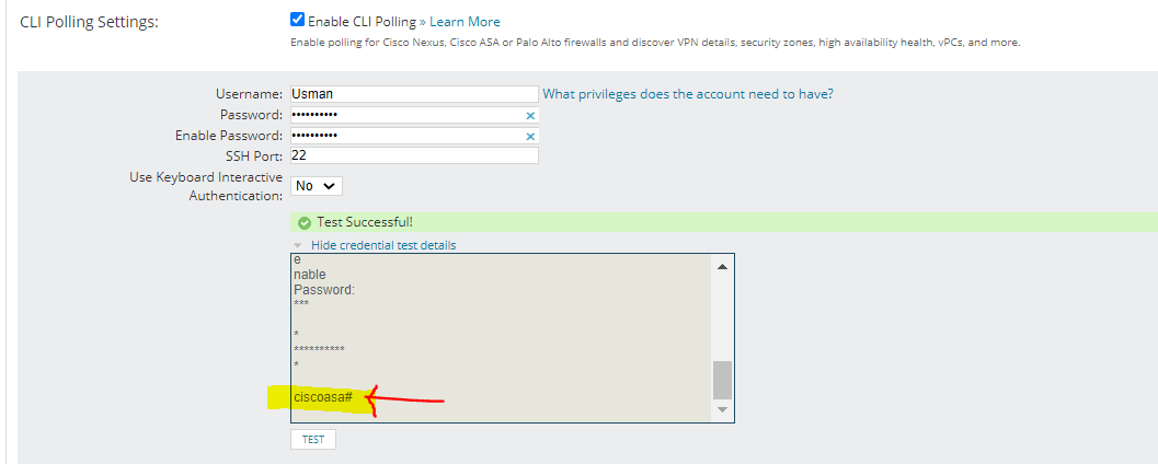

When testing CLI Credentials, please make sure you can see Cisco privileged mode #
2020-03-12 15:05:46,781 [147] INFO  SolarWinds.Orion.Cli.BusinessLayer.Managers.CliCredentialsManager - ValidateLogin Started HostName:192.168.1.1 UserName:Usman TemplateId:76
2020-03-12 15:05:46,859 [147] INFO  SolarWinds.Orion.Core.Common.JobEngine.JobScheduler - Creating default JobEngineV2 binding (netNamePipe)
2020-03-12 15:05:51,703 [235] INFO  SolarWinds.Orion.Core.BusinessLayer.OneTimeJobs.OneTimeJobManager - Result of one time job 5dc6223a-4771-41f4-a127-1eef522f5948 received
2020-03-12 15:05:51,703 [147] INFO  SolarWinds.Orion.Cli.BusinessLayer.Managers.CliCredentialsManager - ValidateLogin Complete on HostName:192.168.1.1 IsError:False

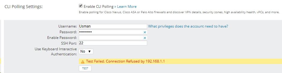

Example Case:  Failure connection
2020-03-12 15:10:17,938 [228] INFO  SolarWinds.Orion.Core.Common.JobEngine.JobScheduler - Creating default JobEngineV2 binding (netNamePipe)
2020-03-12 15:10:19,644 [45] INFO  SolarWinds.Orion.Core.BusinessLayer.OneTimeJobs.OneTimeJobManager - Result of one time job f284b7ee-a783-42b8-b00e-e6d9ea09c5ef received
2020-03-12 15:10:19,644 [228] INFO  SolarWinds.Orion.Cli.BusinessLayer.Managers.CliCredentialsManager - ValidateLogin Complete on HostName:192.168.1.1 IsError:True.

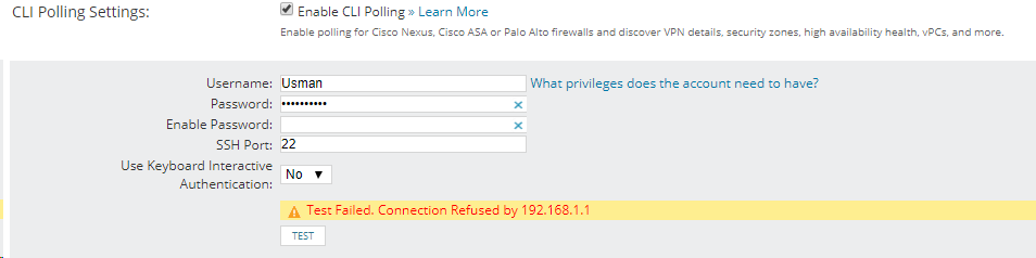

For example, in case of any failure, the CLI Session Trace will show the reason. Example Cisco ASA
  1. Incorrect Password
  2. Use Keyboard Interactive Authentication is Yes.  Set to No.
[4a1c226c] [03/21/2020 13:27:33.100] Device Template: 76  Generic Cisco Adaptive Security Appliance - 1.3.6.1.4.1.9.1
[4a1c226c] [03/21/2020 13:27:33.100] Try Acquire Connection...
[4a1c226c] [03/21/2020 13:27:33.100] Connection Acquired
[850b073c] [03/21/2020 13:27:33.100] -----------------Net. SWTelnet v7.11.0.412-------------------
[850b073c] [03/21/2020 13:27:33.100] UseCustomMorePromptBehaviour: False
[850b073c] [03/21/2020 13:27:33.100] MorePromptKey:
[850b073c] [03/21/2020 13:27:33.100] Custom MorePrompt Pattern:
[850b073c] [03/21/2020 13:27:33.131] Login Attempts: 1
[850b073c] [03/21/2020 13:27:33.131] Enable Identifier: #$
[850b073c] [03/21/2020 13:27:33.131] UseExactPromptMatch=False
[850b073c] [03/21/2020 13:27:33.131] Menu-based mode=False
[850b073c] [03/21/2020 13:27:33.131] FreezeLoginForPreCommands mode= False
[850b073c] [03/21/2020 13:27:33.131] CommandCharKey = Default
[850b073c] [03/21/2020 13:27:33.131] FISP mode= False
[850b073c] [03/21/2020 13:27:33.131] EncryptionAlgorithm= encAny
[850b073c] [03/21/2020 13:27:33.131] WODSSH Version: 2.7.2.180
[850b073c] [03/21/2020 13:27:33.131] UseVirtualPromptForCommands False
[850b073c] [03/21/2020 13:27:33.131] Responce Timeout in seconds: 15
[850b073c] [03/21/2020 13:27:33.131] Connection Timeout in seconds: 45
[850b073c] [03/21/2020 13:27:33.131] Resx Culture is: English (United States)
[850b073c] [03/21/2020 13:27:33.131] Encoding: Unicode (UTF-8)
[850b073c] [03/21/2020 13:27:33.131] Process Architecture : 32-bit
[850b073c] [03/21/2020 13:27:33.131] StateChange: Connecting
[850b073c] [03/21/2020 13:27:33.194] Got HostFingerPrint: System.Byte[]
[850b073c] [03/21/2020 13:27:33.209] SWTelnet9 Crypto Information Begin
[850b073c] [03/21/2020 13:27:33.209] Protocol = SSH2
[850b073c] [03/21/2020 13:27:33.209] RemoteName = 192.168.1.1
[850b073c] [03/21/2020 13:27:33.209] SCcipher = AES128ctr
[850b073c] [03/21/2020 13:27:33.209] CSCipher = AES128ctr
[850b073c] [03/21/2020 13:27:33.209] Keys = ssh-rsa
[850b073c] [03/21/2020 13:27:33.209] SWTelnet9 Crypto Information End
[850b073c] [03/21/2020 13:27:33.209] StateChange: Disconnected
[850b073c] [03/21/2020 13:27:33.209] TimerTick: Killing session timer.
[850b073c] [03/21/2020 13:27:33.319] Connection Error : WeOnlyDo.Exceptions.SSH.AuthorizationException: Authentication with the server failed.
   at A.B.E(Int32 )
   at A.B.d(Int32 )
   at A.B.A(IAsyncResult , Int32 )
[850b073c] [03/21/2020 13:27:33.319] TimerTick: Killing session timer.
[850b073c] [03/21/2020 13:27:33.319] Force Disconnect
[850b073c] [03/21/2020 13:27:33.319] ERROR WODSSH: Authentication with the server failed.

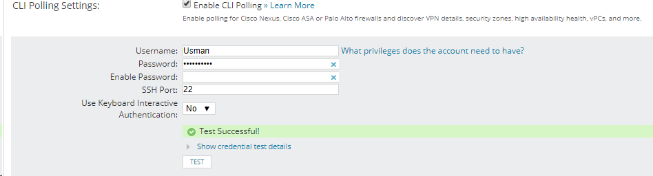

Success Connection will show now Error under Session Trace
[7ae23765] [03/21/2020 13:24:55.406] Device Template: 76  Generic Cisco Adaptive Security Appliance - 1.3.6.1.4.1.9.1
[7ae23765] [03/21/2020 13:24:55.406] Try Acquire Connection...
[7ae23765] [03/21/2020 13:24:55.422] Connection Acquired
[6d9e14f5] [03/21/2020 13:24:55.422] -----------------Net. SWTelnet v7.11.0.412-------------------
[6d9e14f5] [03/21/2020 13:24:55.422] UseCustomMorePromptBehaviour: False
[6d9e14f5] [03/21/2020 13:24:55.422] MorePromptKey:
[6d9e14f5] [03/21/2020 13:24:55.422] Custom MorePrompt Pattern:
[6d9e14f5] [03/21/2020 13:24:55.422] Login Attempts: 1
[6d9e14f5] [03/21/2020 13:24:55.422] Enable Identifier: #$
[6d9e14f5] [03/21/2020 13:24:55.422] UseExactPromptMatch=False
[6d9e14f5] [03/21/2020 13:24:55.422] Menu-based mode=False
[6d9e14f5] [03/21/2020 13:24:55.422] FreezeLoginForPreCommands mode= False
[6d9e14f5] [03/21/2020 13:24:55.422] CommandCharKey = Default
[6d9e14f5] [03/21/2020 13:24:55.422] FISP mode= False
[6d9e14f5] [03/21/2020 13:24:55.422] EncryptionAlgorithm= encAny
[6d9e14f5] [03/21/2020 13:24:55.422] WODSSH Version: 2.7.2.180
[6d9e14f5] [03/21/2020 13:24:55.422] UseVirtualPromptForCommands False
[6d9e14f5] [03/21/2020 13:24:55.422] Responce Timeout in seconds: 15
[6d9e14f5] [03/21/2020 13:24:55.422] Connection Timeout in seconds: 45
[6d9e14f5] [03/21/2020 13:24:55.422] Resx Culture is: English (United States)
[6d9e14f5] [03/21/2020 13:24:55.422] Encoding: Unicode (UTF-8)
[6d9e14f5] [03/21/2020 13:24:55.422] Process Architecture : 32-bit
[6d9e14f5] [03/21/2020 13:24:55.422] StateChange: Connecting
[6d9e14f5] [03/21/2020 13:24:55.469] Got HostFingerPrint: System.Byte[]
[6d9e14f5] [03/21/2020 13:24:55.547] SWTelnet9 Crypto Information Begin
[6d9e14f5] [03/21/2020 13:24:55.547] Protocol = SSH2
[6d9e14f5] [03/21/2020 13:24:55.547] RemoteName = 192.168.1.1
[6d9e14f5] [03/21/2020 13:24:55.547] SCcipher = AES128ctr
[6d9e14f5] [03/21/2020 13:24:55.547] CSCipher = AES128ctr
[6d9e14f5] [03/21/2020 13:24:55.547] Keys = ssh-rsa
[6d9e14f5] [03/21/2020 13:24:55.547] SWTelnet9 Crypto Information End
[6d9e14f5] [03/21/2020 13:24:55.547] StateChange: Connected
[6d9e14f5] [03/21/2020 13:24:55.547] Connected!
[6d9e14f5] [03/21/2020 13:24:55.547] -->Type help or '?' for a list of available commands.
[6d9e14f5] [03/21/2020 13:24:55.547] ProcessLogin State: Banner
[6d9e14f5] [03/21/2020 13:24:55.547] -->ciscoasa>
[6d9e14f5] [03/21/2020 13:24:57.438] TimerTick: mstrData=<ciscoasa> > State=Connected
[6d9e14f5] [03/21/2020 13:24:57.438] Pending Disconnect = False
[6d9e14f5] [03/21/2020 13:24:57.438] Sending something to get a banner
[6d9e14f5] [03/21/2020 13:24:57.438] <--
[6d9e14f5] [03/21/2020 13:24:57.438] -->
[6d9e14f5] [03/21/2020 13:24:57.438] ProcessLogin State: Banner
[6d9e14f5] [03/21/2020 13:24:57.438] -->ciscoasa>
[6d9e14f5] [03/21/2020 13:24:59.453] TimerTick: mstrData=<ciscoasa> > State=Connected
[6d9e14f5] [03/21/2020 13:24:59.453] Pending Disconnect = False
[6d9e14f5] [03/21/2020 13:24:59.453] TimerTick: send CRLF to get the prompt
[6d9e14f5] [03/21/2020 13:24:59.453] <--
[6d9e14f5] [03/21/2020 13:24:59.453] -->
[6d9e14f5] [03/21/2020 13:24:59.453] ProcessLogin State: Banner
[6d9e14f5] [03/21/2020 13:24:59.453] -->ciscoasa>
[6d9e14f5] [03/21/2020 13:24:59.453] Custom Prompt detector detected a '>/#' prompt
[6d9e14f5] [03/21/2020 13:24:59.453] no credentials needed - Command mode prompt detected
[6d9e14f5] [03/21/2020 13:24:59.453] Prompt being set to: ciscoasa>
[6d9e14f5] [03/21/2020 13:24:59.453] Logged into device
[6d9e14f5] [03/21/2020 13:24:59.453] Force Disconnect
[6d9e14f5] [03/21/2020 13:24:59.453] StateChange: Disconnecting
[6d9e14f5] [03/21/2020 13:24:59.453] StateChange: Disconnected
[6d9e14f5] [03/21/2020 13:24:59.453] TimerTick: Killing session timer.
[6d9e14f5] [03/21/2020 13:24:59.453] Disconnected - From: 192.168.1.1
[6d9e14f5] [03/21/2020 13:25:55.427] Force Disconnect
